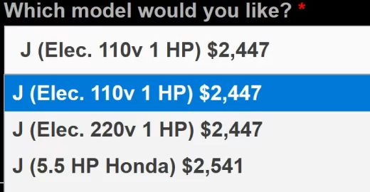

Also the J model should have enough tonage. I drove up to mass and got mine right there , talked with Paul. To late for tax free holiday deals .
For me, the tax comes to the same number as the shipping cost. That say should be 4 to 8 weeks. I once ordered .
