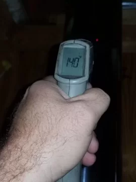

My history was mostly woodstoves on the farm into a masonry chimney. Had pellet stoves for years after that. I am concerned what this fireplace will do when it's 20 below zero out. Begreen, I have been using a Laser temp gun on the frame above the door and it runs about 100* cooler than the door. Can't come up with a 2" thermometer anywhere but again, it runs cooler there. No really good place to get a good temp reading on this unit.

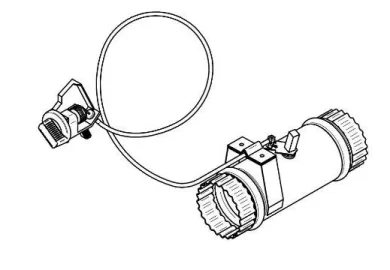

This damper kit would at least slow it down to keep temps down i would hope. My other hope is when i get the booster fan done in the basement that will draw some of the excess heat off the unit......

I'll call them to find out the size. Guess a guy will have to add 100 degrees to it. The outside edge above the door was running about 175, Right about the middle where their was no room for a thermometer was running around 250 and the cast iron bar where i have the current thermometer was running 350 last night. Warmer tonight so it's not on......
No need to add, the stove body is temp is not what you will read on a narrow strip of metal on the door. Running the fireplace too cool will soot up the glass and the chimney.

Highbeam, Was thinking of ordering this as i could shut the intake down all the way. All intakes are closed off except for the 4" running outside.....
(broken link removed to http://files.drolet.ca/upload/images/accessoires/manuels/4-fresh-air-intake-register-with-airtight-damper_Manual_010.pdf?_ga=2.155628283.1354691197.1508810378-1809590191.1507051727)
That would help! Would be a last ditch safety mechanism. To heck with emissions when the alternative is a burned down house. Otherwise you run outside and shove a plug in the intake.

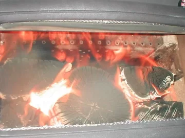

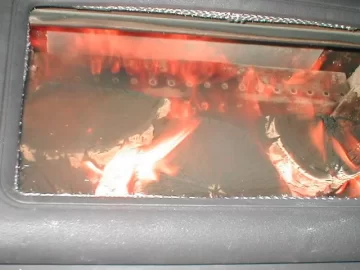

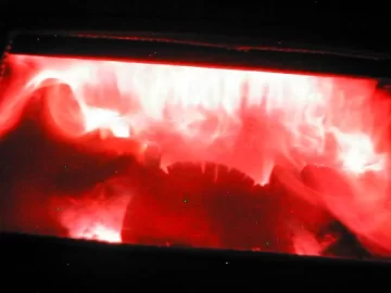

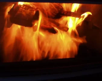

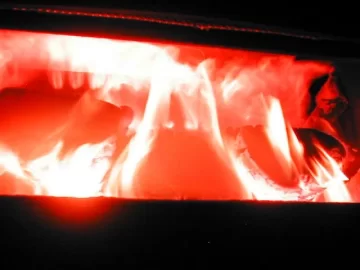

Really windy today. Hotter than it has ever run. This is as low as the draft will go.....
Looks pretty normal.
That's how my hearthstone was. All the way shut off it would roll those non-cat flames for a long time. I just had to sit back and be confident that it was installed correctly and was designed to burn clean and hot regardless of user input. If those gasses that you see burning weren't being burned then they would be escaping your chimney as pollution.
After the bloom of volatile wood gasses settles down, the flames usually also settle down. Might be a couple hours though.
Measuring temperature on the door like that is not representative of "stove temperature" but I don't know what else you can do on a fireplace..

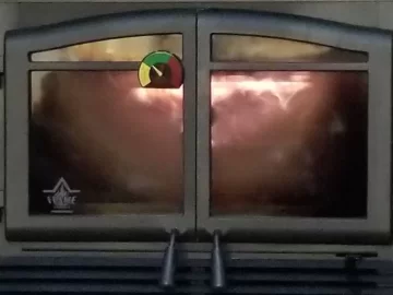

A 2" thermometer will fit on the stove face right above the door. That's where it would be on my fireplace.
That secondary burn looks fantastic. I could sit and watch that all day long. And you're temp look good. You shouldn't have any worries about that burn.
Looks perfect to me. Notice the flames are from the secondaries up top, that is how it is designed to burn. As Highbeam stated, that is the nasties burning off, and exactly how it is meant to burn. Nothing to worry about there. Only time will calm your nerves and improve your confidence, but appears you're doing well. Different set up, but here is the Summit after the nasties are burnt down, and all is calmed & cruising. Not sure I have any with the flames of hell at the beginning, but it is normal.
