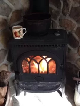

Hi~ I also have a jotul 3CB and I have the SAME problems as you Enlishteacher! My jotul can get UP in temp to 550-600' but it stays there for about 30-45 minutes max, then the temperature plummets from there until it goes out - I am a SLAVE to this stove and it has burnt me out! I am on my 3rd full season with it and I have called the dealer EVERY season, with being told, basically, that I do not know how to make a fire!...They sent techs out to the house the second season - and they installed a 2nd damper (this one on the pipe - it has holes in it - I was reading about the different dampers you wrote about and I was not familiar with the kinds) - well, that helped a "little" - now instead of needing to put wood in every 10 minutes like I did initially, I put it in every 30-40 minutes!....the temperature in the room where the stove is (approx 13' x 13') sets at about 66-67 degrees max with the fire oging!..That's it!...I have 3 fans running in the room and can hardly hear! My house has 4 rooms that need to be heated (each approx 13' x 13') (I curtain off the steps that lead to the upstairs and I curtain off the back part of the house) - the remaining 3 rooms remain cool...:( - Well, the dealer no longer wants to speak with me!...the stove chimney goes through the first floor into the second floor bedroom then up into the attick and out the roof (all in all around 25 ft (??)....and I was told that I most likely have too strong a draft too so I need to live with what it is - so 2 days ago I contacted the North America headquarters in Maine (as I can no longer speak with the dealer (owner of the dealership) because he is tired of listening to me...a rep called me back the same day!...he asked a lot of good questions and some that were very elementary (but he realized I knew what I was saying) and we are to speak again this coming week - just to try "something", he told me to go to my local convenience store and to buy a stack of wood (I guess he was suggesting that my wood is not too good even thought I KNOW it is) - so I tried his experiment (getting the fire up, putting in the new wood, letting it burn for 5-6 minutes then dampering it 1/2 way - and the results were EXACTLY the same! He did say that he wanted his customer(s) to be happy (which were welcoming words)..so when I speak with him this week I am going to ask HIM to come watch the fire and to decide for himself what the problem is or if it is a bum stove! I can't believe that too much draft can't be fixed if indeed that is the problem! I will come back on this site and let you know the verdict!...This has been a HORRIBLE experience for me..and an expensive one! perhaps you have fixed your problem already or have gotten a new stove (?)....If you want the headquarter info. just google jotul north america (Maine)....

The fault is not the stove. To expect this stove to heat a whole house is unrealistic unless the place is a small cabin. It has a small firebox and is designed to be a small area heater. The solution is to put in a properly sized stove for the area that needs to be heated.
