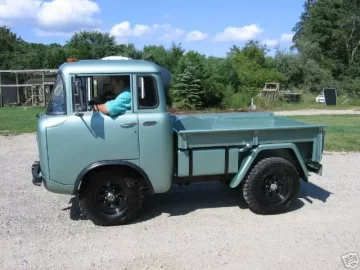

Does this count? This is NOT an actual picture of mine, mine is white and has a plow and the pull ring back bumper (for lack of better terminology). Its a Jeep FC150 (1959).

Would you be willing to part with it?It is a 4x4 right?
THat's beautiful! Is it DOT legal.....................
Sorry Titan, but I think I will keep the old dog. It is a TRUE 4x4 (meaning no hard roads in 4 x 4 mode). It is completely DOT legal, but I do not license it. At a top speed of 53 miles per hour, I don't think I would want to run it on any main roads anyhow. It is really geared low and only has a little 4 cyl. for the power plant. She pulls like a tractor though. Load the bed up with some firewood and hook on to the ring bumper (don't know if it was originally designed for skidding or not, but sure works good), and let her grunt. Its kinda like a baby unimog. Runs like a dream, and for such a little thing, is very capable.
They can still be found, but are getting more rare. Lots of them are getting into "collector" hands now. I don't "collect" nothing that can't still be put to work. Ask any of my old stuff.
