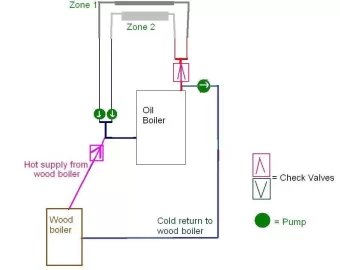

I did more thinking and I think this would be the best solution, what do you guys think?
**edit**
I'm just wondering if I should also have a check valve right under the zone circs (before the hot line of the wood boiler comes in) so that when the wood boiler is pumping it doesn't try to send any up through the zones, but rather it has to go through the oil boiler.

The problem with that one is that if your zones are running, you will be mixing your zone return water with the WB supply water, and feeding that medium temp water into the OB - some of which will then get sent back to the WB on the return loop, and some of which will go through the zones and get cooled further, at which point it again cools the supply water coming from the WB, and so on....
With the closely spaced tees that I was suggesting earlier, any water returned from the zones goes back to the WB, unless the zones are returning more water than the WB can supply, in which case you will still be getting rid of all the return volume that the WB could handle, and only the surplus will get sent around again. (And this scenario is prevented by simply making sure the WB pump is big enough)
Oh, and you should not need a second check valve on the zone side - one 'should' be enough to prevent any reverse flow...
