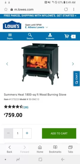

[Hearth.com] Anybody have experience with Englander 13-NC?
That's the Englander 13-NC. Lowes sells it under the Summer's Heat brand. There are many folks here that have owned this stove. It's a good little heater.

If you have to go cheap, not a bad choice, along with the Drolets. If you can spend money, spend some now.
I read some stuff on a warped door and stove body. It was a different model but same brand. Is that a common issue?
That problem is not this stove. It happened with their larger and newest model, the 50-SSW02. The 13-NC has been around for years and is time proven.
