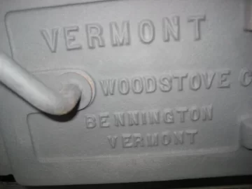

Yes it for sure is a vc stove. And yup exactly why I am here there is no info about them, I’m hoping to upgrade to a defiant sometime this winter yet or by next year at latest. I bought this second one because it was hardly ever used and dirt cheap and I knew everything in the house would match right up. Tonight I’ll get a pic of the door where it says Vermont casting

Everything I have found says simply vermont downdrafter I found nothing saying vermont castings.

Vermont Down Drafter I believe had nothing to do with Vermont Castings. They were made in Bennington Vermont famous for the
Battle of Bennington in 1777 American Revolutionary War, Vermont's version of Bunker Hill.​

Yeah I didn't think it was a Vermont castings stove. For one it's not cast it's plate steel.
