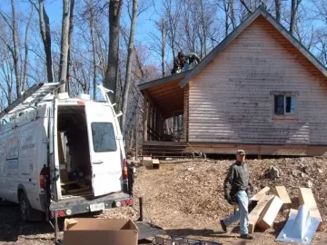

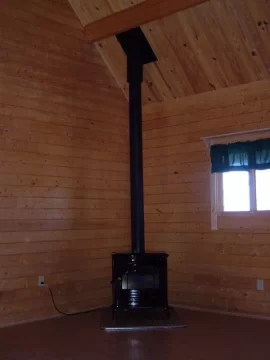

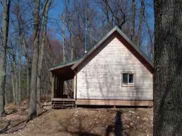

I didn't pay for all these guys to install this humongous chimney just because I needed to get rid of some extra money...it was installed to meet minimum clearances.
Needless to say, the draft'll suck your hat off, if you're not careful...

All that for an electric stove Dan? J/K :)
Not a stick of firewood to be seen and that plug just sort of stood out in the photo to me... made me laugh so I had to share the amusing thought.
That is one clean install - I assume it has worked out well for you.
Well, I only got 2-3 fires before the season ended. Needless to say, I'm chomping at the bit to get back up to the cabin and fire it up this season (next week looks good). I've split a lot this summer, but it won't be dry enough to use...still an issue I need to resolve. Also, now that the stove is in (and a staircase built to the loft), I'm ready to haul some furniture up to the cabin (which'll help hide the electric cord).
