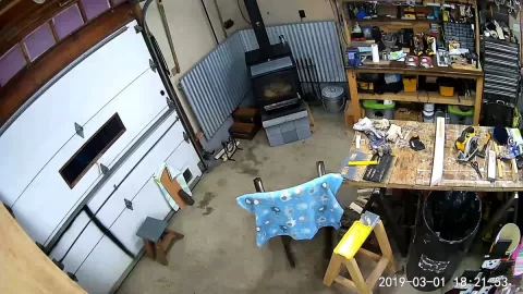

This is my setup... monitors the stove and also the garage door. Also acts as smoke alarm, and has "event" notifications.
Wyze Camera focused on the Garage Wood Stove. Can read both STT & SPT. Can be accessed from anywhere. Total cost---- $26
