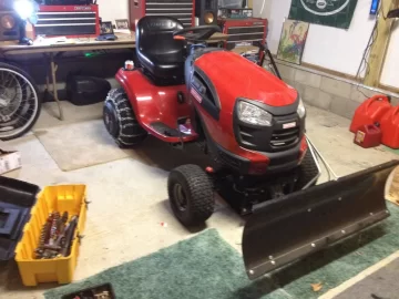

I use my craftsman YT4000 for light wood hauling, from shed to garage, use it to tow my splitter, and to carry logs around.
I just got the ball hitch for it to use with the splitter and my 4x8 trailer. I used it to tow my 4x8 with 9 cinder blocks and a bit of lumber and she wasn't too happy about that.
This is belt driven with a hydrostatic trans, so i'm not sure how much i can tow safely with this. plus the tongue weight must be light, this thing is not meant to tow.
