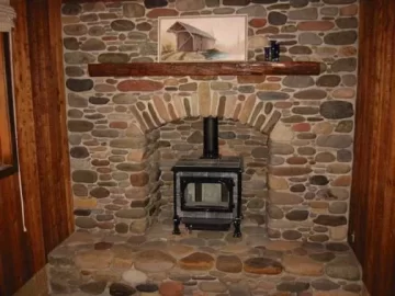

Go with the great room, best all around for aesthetics, heat distribution, more stove options (for longer burn) etc. I am a bit biased towards the look of stoves retrofitted into existing hearths. Or maybe an insert? Is this a whole other discussion now? :eek:
We've decided on the bonus room. That will work best for us.
Is the loft study area connected to the upstairs bedroom or is this a
That doesn't look bad at all! But we're committed to the bonus room. We just had an installer here and he gave us a lot f good information. It will be an easy straight shot up through the roof in the bonus room. He likes Jotul, Vermont Castings and Napoleon.
How tall will the flue system be? How much pipe (stovepipe and chimney) did he estimate?
