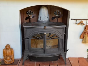

Usually a convective stove works better than a radiant stove in a recess. Can you post a picture of the Defiant in its current location?

Thanks for your response - we posted a picture. We would love to hear your thoughts on the currently-produced VC Defiants and the Lopi Evergreen, which are the two other stoves we're considering. The PE Alderlea T6 LE doesn't appeal to us visually as much, but we'd appreciate your thoughts on it as a stove for our home.

That looks like a tight fit and I think any type of stove is going to do poorly unless you’re able to bring it out a couple feet. A stove that is rear vented would work well here.
The current stove is extremely tight in fit. Do you know what model Defiant this is. The older model 1945 is not permitted to be installed in an alcove. Nor is the current model 1975.
I sincerely hope that the recess alcove was constructed entirely out of non-combustible materials including framing and any materials surrounding it for at least 18".
As far as a replacement, Lopi also has strict alcove requirements. Do you have documentation and pictures of how the alcove was designed and implemented?

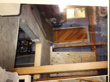

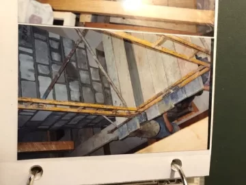

I appreciate your caution. It is indeed an entirely noncombustible structure, build up the center of a post and beam construction (see pics).

It's good to see that. However, I think in order to be kosher with the insurance company, it would need written approval from VC and/or the inspecting authority. I wish stove docs were clearer on this type of install. They show up in too many magazines and online designer sites.
This is what the underwriter sees in the 1610 manual -
NOTE: Installation of the Defiant is not permitted in alcoves.
