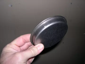

If you decide not to do the vacuum clean-out thing (you can just make it out on my avatar - little 90 degree fitting at the bottom), you likely will have to re-silicone cap each time you remove. It's more of a lid than a cap - friction fit. And for security, it really needs more than the one sheet metal screw in it the way it comes standard - I added two more just to be safe. I'll see if I can snap a pic of the stock one I removed to replace with the vacuum cap...

Here's the pic...
  • [Hearth.com] Anyone have experience with Selkirk tee's and joint sealing.
The part that my thumb is touching fits up inside the 4" pipe; I guess that would be considered the male end. The little lip at the bottom fits flush with the bottom of the tee. Hope this helps!

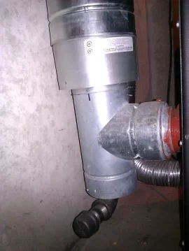

No need to remove the cap, when you have the right set up. ;)
Reactions: jtakeman

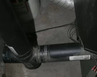

Smoke, If your not removing the tee cap, How do you brush the section of pipe that connects to the stove? I can't use a brush from the blower cavity. I can just sneak it in and send it towards the stove through the tee opening. And thats even a bit of a PITA. So I added a double tee 2 seasons ago. Figures thats whet broke! ;em

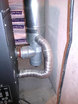

Hey Smoke
The Fresh air tube is 3" Diameter. Did you have to reduce it to 2" ? If so how?

Selkirk DT is the way to go! I installed it on a Hudson River West Point with a 3" fresh air pipe on the back.
See my pics here
https://www.hearth.com/talk/threads/hr-wp-up-and-out-dt-install-with-custom-lighted-hearth.90555/

You should be able to get adapters at the auto parts store for the OAK. FYI.

I would really like to see a pic of the vacuum cleanout! That sounds cool!
Smoke Show beat me to it...see his post above - he's got a nice shot of the vacuum tee adapter. Have not tried it yet since my stove has only been installed for a week, but it looks like it'll work great.

Hey Smoke
I didn't reduce it, just crushed it with the hose clamp. That stove is sitting on concrete, with concrete wall behind it.
If combustibles were an issue I would have reduced it properly.

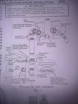

Looks like the kit I need is the 4DTM-UK multifuel. It doesn't use the VP series pipe because it has the AL29-4C Stainless Steel inner liner. Looks like I need to contact Selkirk on what I can use to extend the stove connection. Never easy is it? ;em
Yup- that would be the up and out kit that they put together. You just gotta add straight lengths and then what you need to use to extend the stove connection. Keep us posted and don't fall over from sticker shock! ;)
Heres a pic of the 4DTM-UK you mentioned. So the adapter and the tee aren't the VP series???
