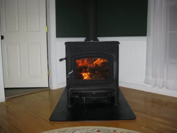

Stove just loaded for the night..f50 Jotul Rangeley
