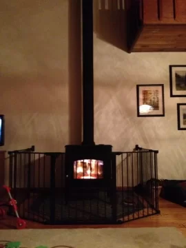

Hi Ray, I have been burning some pretty beefy splits with some success, but even when it got away from me there were 4 splits 6" to 8" in there...I think I'm just new to burning NS after running an Oslo and am still figuring it out. I attached a picture of the stove (not much of a hearth and have to cage her in cause of the little ones). I did look long and hard at the T6, but in the end selling my Oslo almost completely covered the cost of this stove and I didn't have to move any pipe to meet clearances...
