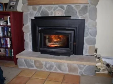

yes, what I am looking for is one for the mantle
the dealer says the hearthstone one goes on the bottom and over the mantle....ugly ......
here is a pic of what I thought they were
  • [Hearth.com] Anyone with Hearthstone Clydesdale Heatshield?

I have the heat shield on my Clydesdale, it is similar to the one you have pictured above, however my heat shield is exactly the same length as the surround. It only sticks out at a 45 degree angle 3" at most, so it really isn't much of an eye sore. I've seen other heat shields on other stoves that might have been 8" wide, but at only 3" you will not bump your head on it and really it blends in quite well with the surround. I'll try to find a picture of it at home tonight.
I think the cost was $90 and I needed it for clearance purposes, but all in all its not that bad to look at.
Also mine is the factory heat shield as far as I know. The people who installed my stove put it on. Its not connected to or mounted on the mantel. Its positioned immediately above the surround, just like the picture above except it stretches across the entire surround and blends in a little better... in my opinion.

Hearthstone doesn't make a heat shield for the Clydesdale. They ship the Homesaver shield with the units when they are requested that fit on the bottom of your mantle. You do not have to use this shield with your insert. As others have posted many installers have different shields that will work just as well.
