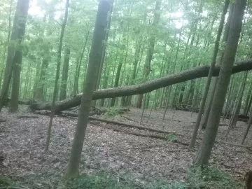

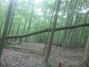

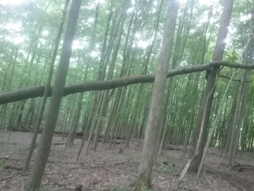

A guy I work with ,works for a tree service,he concurs with you in your method,but he also agrees with Mutineer he's going to look at it saturday,and said don't worry it will come down. THX,you guys are very knowledgeable.I'm only good at cutting, downed trees,splitting and stacking,such is life.I have a long pole saw. I would stand well back, on the side that the tree can't fall toward (the far side of the tree in the photo), and take off the limb with the pole saw. Or as Mutineer suggested, chop off rounds until you can pull it off with a come-along.
Yep--called fence posting. Stay alert--mostly keep your feet out of the way and you'll be fine.I cut trees like that all the time. Start at the bottom end of it, first cut from the top about 2/3 of the way thru and then finish with an undercut and the tree bumps down the length of the round you just cut, gets easier as you go along the log.
Now, when it's a widowmaker that's nearly vertical is when I hook a chain to the bottom and pull with the tractor.
Nice advice,and THX so much for your response,I will hopefully get it done this weekend,and post a few pics,hopefully.I got chainsaw certified by the National Park Service several years ago, the training was specific for the types of trees encountered maintaining the Appalachian trail. The AT is a narrow path through all types of woods and its rare to have tree fall down flat on the ground. Most are leaners of some sort. and frequently its leaners on top of leaners. There is 2 long days to get the initial certification and one day every 2 years to keep it. I let my certificate run out as my "job" is boundary line maintenance which does not require sawing, nevertheless it was great way to safely run a saw.

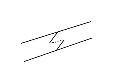

Hard to compress the training into a couple of paragraphs but one of the biggies is the initial assessment of where the stored energy is in the tree. In the case of this leaner its pretty obvious that the stored energy is downwards and also pushing the long in compression towards the root ball. One of the basics of the chainsaw course is to control the cut and release stored energy slowly. One common approach would be as suggested by cutting upwards in a straight cut from the bottom perpendicular to the trunk. The problem with that is there is not a lot of control, optimistically the cut causes the tree to hinge and the butt of the tree to slowly drop down straight to the ground missing your feet. The reality is as you are cutting upwards there is lot of force pushing down through the trunk towards the root ball in the tree and when the tree finally lets go its usually a sudden drop and it may not be straight down, it could jump towards you or away from you quite violently. In some cases with a higher angle of lean, the saw will pinch and on occasion wth high angle leaners the saw will cut all the way through but the force on the tree will keep the tree from dropping.
The key to the following cuts I am going to describe is practice and patience. Before you start these cuts make sure your saw is sharp, you want to be able to control the saw and the only way to do that is with sharp saw that you dont need to lean into.
So what you need is a way of controlling the cut so there is a big hinge to guide the log slowly to land where you want it. The cut we were taught to use is a "Z" cut on large diameter trees. Forgive the crude sketch but the concept is cut the top cut half way through the log at a 45 degree angle to the trunk all the way to the center of the trunk (the dotted line). You will need a plastic wedge and you need to follow the saw with a wedge so the top cut does not close up on the saw and bind it. Once the top cut is done, then the bottom cut is started. As you cut, the "hinge" of wood at the center of the tree is quite wide and controls the energy in the tree . Rarely will you need to go all the way to the dotted line. The tree will slowly start bending at the cut towards the ground perpendicular to the hinge. Just step back and wait and if you need to go back and cut a bit more until it finally lets go.

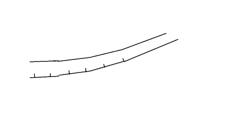

I find it works well but usually skip it on small diameter stuff as smaller diameter trees are more flexible and the saw can pinch during the initial top cut. If its small stuff with a pronounced bend in it, I make a series of shallow cuts from underneath along a 4 foot length of the trunk. Each cut is only 1/2' at a time and then move on to the next point. What will happen is the curve will slowly increase towards the ground. Just keep nibbling a little bit at time. Cut too deep and it will release too quickly.
The same nibble approach works if you have a bent over tree trapped by another tree. Instead to cutting it through and having it whip back uncontrolled, I just flip the sketch over and slowly nibble about a 4 foot length on the top of the tree. The tree will statt to curve upwards slowly and I keep nibbling until the tension is out of the tree or the tree bends upwards at the top of the nibble.
Obviously a lot easier to learn with a skilled instructor looking over your shoulder.

Thanks for the posts on how to drop. Very interesting. On the z-cut diagram above ... any discussion on making a second cut on the top to take out a small wedge from the top, so the tree can fold a little more?
