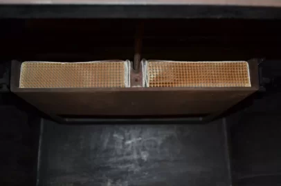

Your stove has a cat in it
The cat is in the damper housing at the top of you stove. I have to run my stove with the by pass open about 1/4" to keep it from back puffing.
