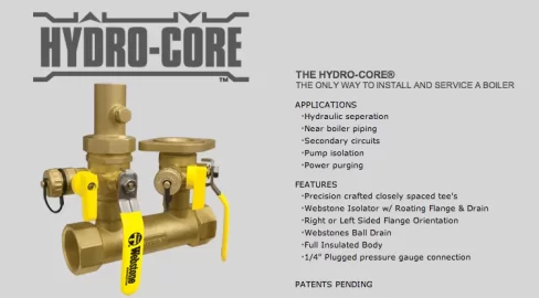

Webstone has a great new valve for P/S piping. All the functions in one component.
