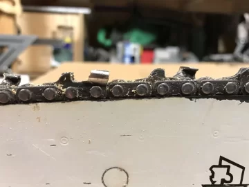

The Stihl in the video has a semi chisel chain, not safety chain. I use one of those angled wheel grinders designed for chainsaw chain to sharpen it. The teeth are all the same length as the wheel grinder has a jig to lock each tooth down before grinding. I think in the future I may use the jig less and use my files more as I feel like the grinder wastes far too much tooth material, but that's a different story.

Assuming my chain tension is correct, I think the reason my bar gets hot is the anemic oiler on the ms290. I had it almost all the way up but the chain never seemed well oiled. Seems to be a common problem on these saws. I've opened up the oiler to max. I'll try a cut tomorrow and see if that helps with the heat build up.
Except the photo you posted is an anti-kickback safety chain.
There's too much sawdust on the teeth to tell for sure but it looks like the wheel grinder you're using is making the wrong radius. It's like it was filed with a file with too large a diameter. I'm not familiar with angled wheel grinders so I can't say whether the problem is the setup or the technique but the result isn't right!
Gah. You're right. Looks like an RM3? I looked it up before the video since it had been years since I bought it and the safety chain picture I saw didn't look like that. I see I just didn't search hard enough though.
I sharpened it at a 35 degree angle, then 30. The wheel also may be the wrong size. I'm not sure how to check, but I'll see if I can figure it out.
