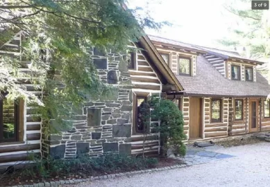

Hence, to avoid loosing many BTUs to the outdoors with a log cabin, an insulation envelope should be present on the outside of the log cabin. But that kills the aesthetics (which are great, see the pics above).

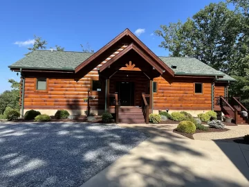

We live in a log home. We love it. We live in NC so we do not get the crazy low temps like other areas. It is not a chinked log cabin. We do not heat exclusively with wood. We have heat pumps. But when we use our wood stove it gets the main level of our home(1800 sq ft) nice and toasty. We do not pack the stove full. There have been times when we need to open the sliding glass doors because it gets too warm for our taste. It seems to hold the heat pretty well. We do not burn overnight. We let the fire burn out before bed. It is still usually 70 on our main level at 4am. When we wake in the morning the heat pump has kicked in. We have a Jotul Oslo V2.

Nice looking home and stove! Is there a spline sealing between each log layer?
Nope. When we first moved in when there were strong winds some saw dust would fall out of the logs in a few spots. It is certainly not energy efficient. I think if we would have done more research we would have looked more into sealing of non chinked log cabins. The logs are tongue and groove D logs.
