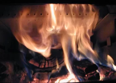

I was going to suggest a wireless camera, so you can at least see what's going on inside the stove... but he wants temperature... don't know. As for an EPA II having secondary at 400... ha, not here, not now, not never. I don't get anything below 550, maybe 500, on a good day.

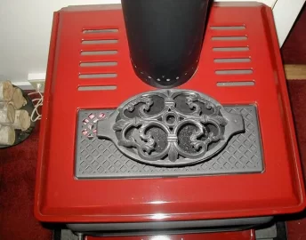

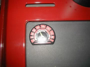

The thermometer is on the top under the trivit ( trivet removed for pictures ) In the pic you can see the stove pipe on the upper right side and the edge of the stove on the left so its dwards the back between the edge and the pipe.
I have two thermometers and they both read the same , one is on the garage stove and i have compaired the two.
I do think that stoves light off secondary burn at or around the same internal temperature but the Summit being a 3/8' thick top plate is whats making the difference , keep in mind the Summit after an 8 hour + burn there is still coal in the ash and the stove top temp can/will read 180° - 215° after 14+ hours so its kinda like the soapstone properties with the thicker steel.
I can load the fire box almost full or full and run the stove at 600° but in a house of 1800 sf and the out side temp over 15° would run us out. We have the option to run the stove hotter for when its 15° ~ minus 20°
The attachment pic shows the placement of the thermometer under the trivet. The thermometer shows the same temperature everywhere on the stove top.

Have to say I'm with Roo on this one. The Jotul F400 starts firing off secondaries around 250. By 300 they're burning well. By 400 degrees it's blue flame territory.
I must have weird air in this area. Neither of the Jotuls or the Englander bust off secondary until 450 t0 500. Oh up top action can be kicked off before that but there is going to be smoke coming out of those three chimneys until 450-500.
At 500 all three of them settle in, clean up and cruise. It is probably my wood or operator error. Or a little of both.
I had the same thought Bart. Went out and checked the stack outside. By then the stove top was at 400. No smoke. But today we have a nice high-pressure system and the stove jumped into action pretty quickly. Burning a combo of 2 yr old cherry and soft maple. Seems the F400 secondaries do kick in faster than the 3CB's. I remember the 3CB as needing higher temps too. Is there a draft damper on your 3CB?
Edit - The air control is much smoother in the F400 and at the bottom of the stove instead of at the top. I'm guessing that the bigger Jotuls preheat the secondary air better than the smaller stoves. Does that sound plausible? MSG any thoughts?

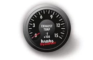

Back to the subject for Dean. Have you looked at diesel exhaust temp gauges? Good ones are pricey, but you can get one with a 55 ft. lead if desired. I could see making up a nice furnace monitoring panel with one of these and and a basement ambient temp unit. Lots of pyrometers for autos on eBay too.
