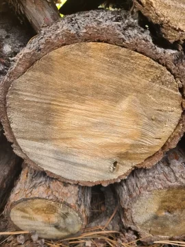

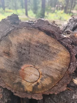

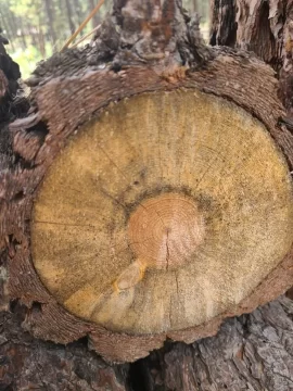

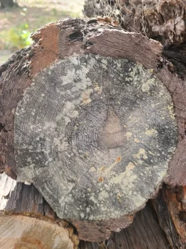

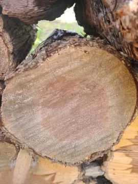

Curious if this is mold? And can I burn or not burn? It does seemed dry.
[Hearth.com] Are these all moldy? [Hearth.com] Are these all moldy? [Hearth.com] Are these all moldy? [Hearth.com] Are these all moldy? [Hearth.com] Are these all moldy?
Yes that's mold. But that's not a problem.
Given that it's not split, I would see if you can measure the moisture content in the center of a newly split piece. Your climate likely is good for drying, but wood generally does not dry well when not split.
Just don't store it in the home, bring it in and directly put it in the stove.
Mold appears when it's still wet, but you can still see it when it is dry. No problem.
If the wood is dry enough as measured on a room temperature freshly split surface, the mold is not an issue for burning.
I am not knowledgeable about whether spores can still spread into your home. If you are concerned about that, I would not store it inside, but move it from outside directly into the stove.
