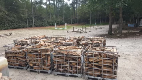

After years of stacking wood in, then moving it to garage and stacking again...I decided to go the tote way.
Filled right at the splitter. Finished manually handling...pick up a few splits every time I pass by in garage & drop in basket by stove. I have 25 of them filled and stored undercover, 3 high.
I'd love to have totes like those.

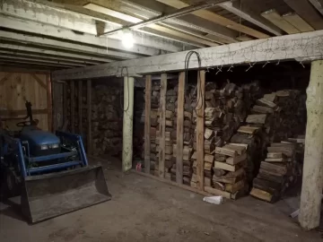

Holds 30+ cords when full, enough to keep 10 rustic guest cabins, an employee yurt, and a main lodge warm through a long Montana winter! (This picture is from a year ago, we're further along on stockpiling wood than this right now!)

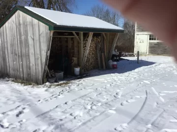

I built this wood shed four yrs ago and am very very happy to have it but there are a few things that I could or should have done differently. The space between the boards is just from shrinkage. I could have kept the look but spaced the boards further apart. Doing the roof I never thought to put in a ridge vent. I could use some gable louvers to help move the air. Steady breezes help. We live in a spot where the laundry on the line is so often horizontal. I’m satisfied with the size, 16x12 ft. It holds 3 1/2 cord of 16 inch rows each side at six or more feet high with good air space between rows. Bigger is almost always nicer but that’s more to build. I had to bring in gravel to fill a steep slope at the back so there was no room to create access to the back where drier unused wood may end up be behind the newer wood. The gravel gives a good floor with crossways boards to hold wood off it. I put some left over geotextile road fabric under the gravel which maybe helps a little more with ground moisture. The 6x6 pressure treated posts are about 2.5 ft deep with 2” of styrofoam surrounding them 2ft out to keep the ground unfrozen. Posts are cross braced. By the way don’t rent a post hole digger if you expect it to dig through gravel. The vibration makes it cave in on itself.
The shed may not be the best for fast drying and I did get mold on some pieces for the first time this year but it does its job. Our cookstove seldom needs cleaning and annual chimney cleanings yield next to nothing. I’ve got to say it sure beats digging our wood from under snow and a frozen tarp.

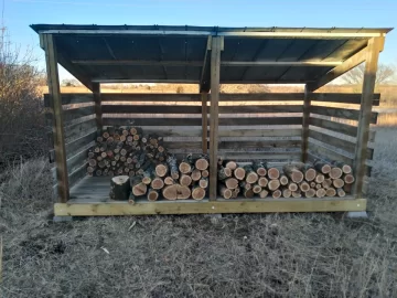

Here's what I came up with after drawing from the Popular Mechanics, Fine Homebuilding, and EPA plans - plus looking through everyone's on this thread. I had a bunch of salvaged materials from a porch I had torn down so that drove the size. There were a lot of 6' pieces of 5/4 deck boards, and I let the pitch of the roof and length of salvaged 4x4s I had on hand drive the height with the galvanized roof panels leaving a little overhang. I ended up buying 4 treated 2x6x12s, a box of joist hanger nails, a box of 16D galvanized nails, a box of 4" exterior screws, and a 25 lb box of 2 1/2" decking screws (overkill on the weight but needed them for later projects). Everything else was salvaged down to the precast footings and joist hangers. It should hold about 2 cords. I'm hoping I go through about 1 cord per winter at most with the VC Aspen C3 and my small house in this climate (and random 60+ degree winter days like we're having so far).
My only concern is that I may have to support the outer 2x6 spans between the 4x4s/deck footings, as the joists are running perpendicular into them with hangers. If so that will be easy enough to get to and stick footings/cinder blocks under them.
I was worried about a 50+ MPH wind tipping the thing over so I loaded as many cut pieces of wood at the front edge and will split them as time allows. It's not moving anywhere now.

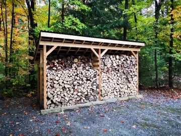

Here's my shed I just built a month or two ago. Holds about 5 cords.
Nice...Do you know what material cost for this? and size thanks
