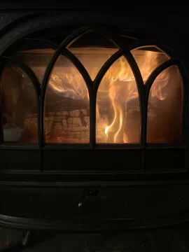

Are these good secondaries?
Looks like nice hot fire to me. What happens if you turn it down from there? Do you see more fire at the top and less at the bottom?
super good secondaries would be dancing around at the top of the burn chamber or jets of flame from 2nd burn tubes due to off gassing of the wood. depending on where your air control is set you may not have flames directly off of the wood
That doesn't look like much secondary combustion to me but that might just be because the smoke is being mostly burnt by primary combustion. I can see some on the top left and the left side in general is closer to full secondary combustion where the flame is detached from the logs.
The fire looks hot enough for them in the video so it might not have been turned down enough or for long enough. With good secondary combustion it looks almost like you are porting natural gas into the top of the stove.
You may also need to hold the camera a little closer to the ground so we are kind of looking up into the stove for a better view of the burn tubes.
I’m sure we could see them in that video if they were rolling, but I didn’t see much to say that the secondary burn was rolling.

Something more like this where the flames are coming out of the small holes in the secondary tubes, while there may be only some small flames reaching up from the splits below. For the absolute best there would be almost no flames by the splits and all the fire is coming out of the secondaries.

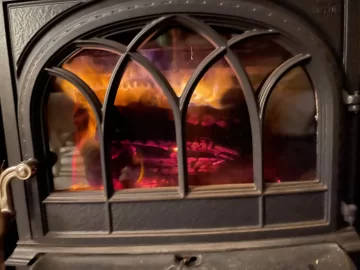

Here’s an update video, it been like this for 3 hours already !!
How far is the air control open in that burn?
Good secondaries, but as others said, you want smaller flames coming off the wood. That's why your flue temps are high; You're sending a lot of heat up the chimney with those big flames off the wood.
If your air is closed and it's still burning that hot, try cutting the air more aggressively at the start to control the burn more. If you get too much wood burning at the beginning, it's really hard to slow it down.
Or if you need to cut the draft lower for a slower burn, put in a second flue damper. I have two flue dampers stacked, on both or my SILs' stoves. One stove is a PE T5, and that thing drafts like crazy on just 16' of chimney. The second flue damper made a noticeable difference.
