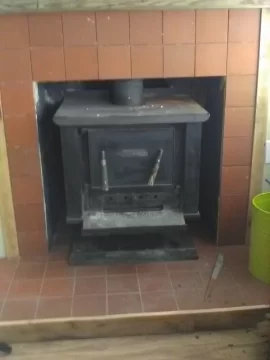

Arrow wood stove not putting out much heat
mickri
Jan 2, 2022
17
California
This is the second winter that I have been using my Arrow 1800A wood stove. It is a horrible design. It has a metal box where the wood burns inside an outer metal box. It doesn't radiate heat. The only way to get heat out of it is to have the fan running blowing air through the space between the inner and outer boxes. And the heat that does come out is luke warm at best. In looking at the inner box there are fire bricks (wrong term??) lining the sides of the inner box about half way up the sides. I am thinking about removing them so that the bottom half the inner metal box where the coals sit can get hotter. Any potential problem with that? I also think that I need a new rheostat for the fan. There is virtually no difference in the air flow from high to low on the fan speed. It runs at high speed. I think that this pushes the air too fast for the air to get heated.
And wood doesn't burn very good. The combustion air comes through the floor of the inner box. When the floor gets covered with ash, even a thin layer, wood doesn't burn. It tends to smolder and smoke. Open the door and it blazes away. The Fischer stove in my previous house had the air vents in the door. I could male similar vents for this stove.
Looking for suggestions on how to get this stove to put out more heat.

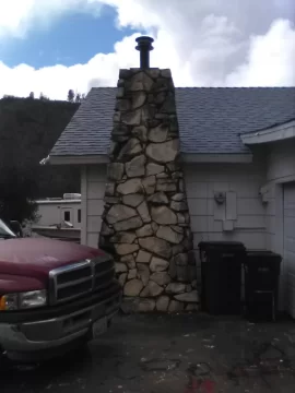

I ran a 6" single wall flue pipe centered inside the chimney and out the top for a couple of feet. The stove manual spec'd 12' of flue pipe to draw properly and that is what I installed. I made a cap to cover the top of the chimney that the flue pipe goes through. It is not a tight fit to the chimney. I could seal it up. There is a spark arrester cap on the top of the flue pipe.
The outside of the chimney is rock with I believe a clay chimney flue inside dimensions of around 13" by 15".

Single wall flue pipe can't be run in a chimney. It should be a stainless steel liner.
A block off plate ay the bottom will keep heat in the home, and insulation behind the stove as well.

This afternoon's project was to clean the ash out of the stove. Since I was doing that I decided to take out what I had thought were fire bricks lining the walls of the fire box. Turns out what I thought were fire bricks were actually 3/8" thick cast iron plates. There was a gap behind the plates that was filled with hardened ash and there was ash caked onto the sides of the plates. There was also ash caked onto the walls of the fire box. I think the ash was acting like insulation keeping the wall of the firebox from getting hot. The gap I think is meant to provide air to the fire box when ash covers the floor of the fire box. Will have to see about that.
Removing the ash made a big difference in the temperature of the air coming out of the stove. The air is now warm like what would come out of a heater vent. And the heat was consistent from the bottom to the top of the vent on the stove. Before it was cooler at the bottom of the vent and got a little warmer towards the top of the vent.
Making progress.
Reactions: begreen
mickri
Jan 2, 2022
17
California
Cleaning out all of the caked on ash off of the cast iron plates made a big difference in the heat produced by the stove. Still have the same issues with how wood burns. I think this stove was designed for a slower burn rate. And some of the wood that I burn may not be the best. All in all the stove now keeps my little house warm enough for me. The heat even makes its way back to my bedroom. That didn't happen in the past.
