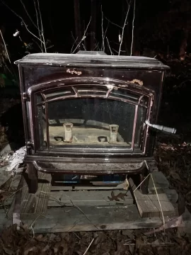

Well, we looked at the Explorer II. We really love the look of it, looks like it will fit our space well. It has features I really like, ie the large flat top, enamel finish, large window, good size fire box, close clearances, right side door opening…
The problem is the stove has been stored outside. The owners evidently had it one season, then moved. They weren’t able to fit it in their new home so it went outside under a carport. From the look of it, it was perhaps dinged up during moving, then stored outside where rust took over. The rust spots are not terrible, but will need to be buffed out and then the paint touched up. The firebox looked good, maybe some very mild surface rust in one spot but not bad. The concern is if there’s any rust internally…this is a layered piece, with steel then cast iron as the shell. The fear is there may be rust in between the layers. Hubby operated all the levers and said they felt good. The door worked well, gaskets are in good shape as well. It is going to need a couple of bricks replaced.
We talked to the sellers for awhile, and ultimately they offered it to us at $1000.
So, what would y’all do?
Does anyone know if the back of this unit can come off somewhat easily to see if there is internal rust issues? That would certainly help us make the call.
I’m attaching the picture only I got of the unit, although it’s dark. The light brown spots are the rust spots. The front is the worst of it. The white spot on the door is actually a bug nest of some sort…but not damage.

OK, $1000 is more realistic. It was a beautiful stove in its day. It's a shame they abused it by leaving it outside, but inside the firebox it's a simple tube stove and probably ok. If anything has seized up due to rust it is probably the Automatic Combustion Control (ACC), which is a timer based start up air system. Checking that out would require removal of the right side cast iron panel. The stove can still function without the ACC.
