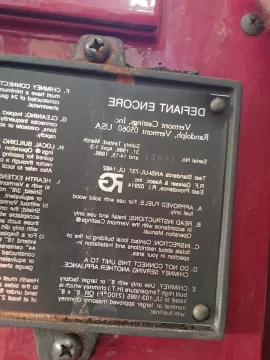

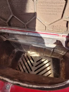

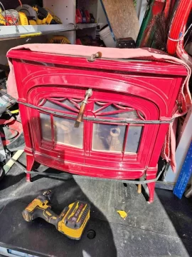

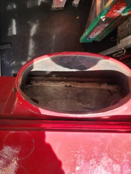

This is a local VC Defiant Encore that's popped up -- any insights on it? I know, they're just pics...I can't quite tell the age, nor can I see the number stamped on the back wall but it looks like it ends in an "8" -- 1988 perhaps? Does anyone know the model this is so I can do more research? Many, many thanks! and sorry image of the back label is reversed, that is how it looks in the ad...
Oh asking price is $500 if that would sway your opinion :) Much better than 2000!

The odds are that the stove will need servicing and possibly part replacements. I would not start out with this.

I hear you, however as it turns out this is being sold by a man who owns a chimney/fireplace/stove service company that is highly rated, he is claiming it’s in great condition…but I understand there are risks down the road, even if it is truly in great shape today.
VC was my first love when we went looking a few years ago, I guess I need to give up the dream haha

Did he say what model number Defiant this is? There are at least 3. Will he certify that the combustion package and catalyst are in very good condition?
They are beautiful stoves so I can appreciate the appeal. We had the original Resolute many moons ago and really liked it. Unfortunately, the modern ones are more complex and have some fragile firebox components that one needs to be aware of.
