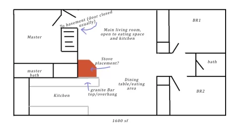

How about posting a sketch of the floor plan. Show where you intend to put the stove. Post a few pics as well. This will help with recommendations.
Here's a rough drawing of our layout, hope this helps!
I don't have any pics of the place to put the stove, but the plan is a corner install between our bar top area and an interior wall (the red bit being where I envision a hearth). The overhang is granite and will essentially become a warming shelf.
[Hearth.com] As new as it gets
That is a rather ideal position for a stove!
Looks good. This is not a typical ranch with all the bedrooms and bath down a hallway wing. The open layout will make heating more even and comfortable. The master bath might be cooler. If so, try the fan trick.
