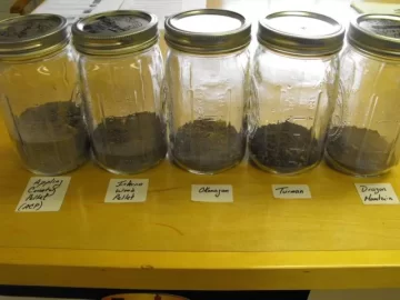

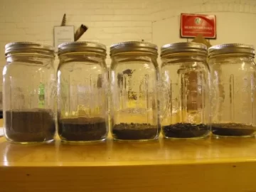

I have been waiting until it has been cold enough to run this ash comparison. Well I finally have it completed.
As you can see by the ash content in the jars there is definitely a difference in the ash content from different pellets.
Left to right - Appling County (ACP) , Inferno, Okanagan, Turman, Dragon Mountain
Lots of folks on this forum and customers say, including salespeople at most Big Box retailers, that a pellet is a pellet. Well those people are wrong. As far as I am concerned- when you take your hard earned $ why would you want to buy ASH, NO HEAT and FINES. If you purchase good quality pellets your $ comes out the front of your stove in HEAT and you don't have to clean your stove as much - meaning your $ goes further.
You decide how much $ you want to spend - I just wanted to give the results.

good job on the comparisons.....is that just the ash from your fire pot or the ash from the whole stove after each bag?
My Apology - The test was done with one 40 lb bag of each pellet.
I swept out the stove and collected all the ash from the burn pot and everything in the ash pan. The stove was clean after each burn.
neat. how did you do this? how many pellets do the amounts of ash represent? assuming you must have collected the ash from a single bag (?).
now--we can see how much "volume"; the real measurement would be how much do they each weigh? some ash might be "fluffy-er" than others, and therefore, take up more space...but might actually be a smaller percentage of the original mass.
In regard to the weight of the ash - I don't think it matters. You still have to clean all the mess when you buy a pellet with High ASH.

Life isn't fair and we compete head to head with these two higher ash brands everyday...."Rules in a knife fight?"
Yes, Life isn't fair! Thinking your getting a great deal on inferior pellets ins't fair either! :ahhh:
Is it really worth saving $20 to $30 a ton for twice the ash and far less heat?? You actually may spend more money on trying to get the overall heat out of the stove. You will have to burn more LBS./HR. to get the heat your looking for!
