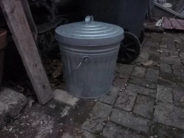

My stove has an ash drawer and I like it. It keeps the dust down from shoveling out ashes. I personally keep a galvanized 33 gallon trash can with lid on the back porch. I empty my ashes into that trash can and they can sit there for weeks and cool. I normally fill that can up twice per season. It's easy enough to run my hands through the top few inches feeling for warm spots, so that's what I do. Since my back porch is wood, I leave two or three insulating inches of ashes in the bottom of the can when I empty it. I spread the ashes around the yard, fill in holes, around fruit trees, in the compost pile, just where ever I feel like it at the time. I avoid concentrating all my ashes in one spot.

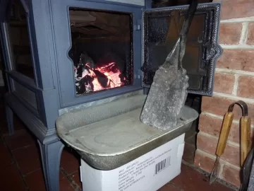

The nice thing about an ash pan is that you get less ash dust floating around the house. But I have had to shovel the ash out, and dust can be kept to a minimum if you are careful. I used a long, shallow pan, held it directly under the door, then gingerly slid the ash off the shovel into the bottom of the pan. Do that when it is cold out, and you have good draft pulling any escaping dust back into the stove. In the attached pic, I have the pan on a box to take the pic but when actually shoveling ashes out, I held it there with my other hand.

33 gallon trash can with lid on the back porch...I normally fill that can up twice per season.
You burn that much wood in GA? You must have a bigger house to heat. I fill a EDIT: 10 gal. bucket, maybe three times. Our place is small but with minimal insulation and some air leaks, probably equivalent to heating a 1500+ sq.ft. house.

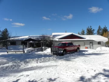

I just sprinkle it on snow pile. Problem solved. Works every time. Of course we get 4-8f of it every year.
Sounds like you get winter there..unlike the coast. ;)
Last Feb 19, 2018. About 1/2 had melted. Finding place for ashes is not hard. We get down to -20f sometimes. Some snow. Never seen more than 20" overnight.
