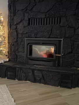

New here! Not sure how this forum works. Or if I need to start a new thread But I just had a BK Ashford 25 installed last month and love it!
However. Couple things I’m not liking or am struggling with.
The door doesn’t stay open when loading. You can open it all the way to its max and it’ll slowly swing closed. The unit is level so I know it’s not that. I have a 3rd degree burn on my bicep to show for it trying to load it at 2 am in the dark. Is there an adjustment I can make to this.
Secondly. The bypass door doesn’t shut all the way with out slamming the rod multiple times. I had no idea it recessed back behind the face plate till it happened on accident. My burn times improved significantly after figuring this out but it almost acts like something is pushing back against it.
3rd. If I use the air control at all the door smokes out severely in the bottom corners especially in the hinge side I’ve adjusted the door to tighten the gasket and it helped a bit on the latch side the door came from the installer with probably a 1/4 gap when latched and I had smoke and flames coming out on first fire
Last thing. The latch is a mother f’r to open and close its super tight
Even when not trying to shut the door just operating the latch up and down. Do I need to lube something? Use graphite or what? The latch bar itself has a slight bow to it and has since installed.the installer said this was normal and the latch would break in but hasn’t.
Any help or advice would be much appreciated.

Something sounds wrong with the door, that is a host of issues with a new stove. Has the dealer been out to help you with this?
okay, let me post here what I posted on the other thread (where I think the post of the OP will be removed soon as it deserves its own thread).
My door does not slowly close - and I have not even checked whether the stove is exactly level.
The door gasket leaking is a serious issue. That needs to be resolved so that it passes the dollar bill test (stick a bill between gasket and stove body, close the door, pull out the bill - it should have some resistance). Otherwise too much air comes in, wasting efficiency, endangering the cat, and leading to less control over the fire.
I think your installer needs to come in to do this (door leaking) AND the bypass lever thing right. You don't want to bang on a hot stove - nor should you be needing to.
I hope that @BKVP can provide suggestions for the door slowly closing issue (given that the insert is level).

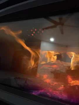

I feel like the flames are rolling pretty hot right now and as you can see the cat is only active on the left hand side
The cat can be active even when not glowing.
Reactions: stoveliker

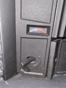

Misfitting door, broken cat gauge window, bypass lever needing too much force.
That is a collection of mechanical issues that I would demand be resolved. Indeed has this thing been dropped?
The totality of this is rather concerning to me.

The cat only glowing on one side is not an issue.

The cat thermometer on the AF and SC25's in a switch. It does Not gradually increase. Once the cat hits 550F, the needle points around 12 to 1 o'clock and goes no further.

And the bypass lever issue? (Having to bang on it...)
