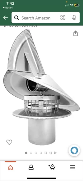

That is draft issue. The delayed ignition you described are also likely to insufficient draft. Does cap have spark arrestor screen?
Not sure. This is what’s installed on top
