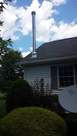

I can get on the roof but I can't reach the top of the pipe. It now has 2 support brackets. This picture was during the install.

One big difference I see between you and I is that your pipe is on an outside wall of the house. Mine is inside the envelope of my house and attic coming out the center of my house. I bet that pipe is cooling and you're losing draft relative to mine because my attic keeps my pipe warm...
I would guess that you are gonna need to create more draft to fix this issue. In the meantime, you can try to compensate with drier wood, burning at higher temps, etc.
