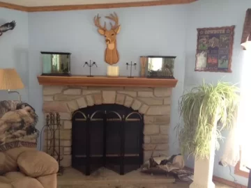

Really could use some help.
I have a Temco ZC fireplace and alot of the heat goes up the chimney. I'd like to put in a wood insert and was looking at a PE model. The dealer and installer is telling me no problem will work fine and they will put a SS liner in chimeny.
I stopped at a different dealer to check out Jotul models and this dealer tells me they absolutely will not install and insert in ZC fireplace. That's not a good idea.
Now I'm more confused than before and unsure about the safety of doing this. Suggestions? My husband is against tearing the corner apart and putting in a stove. Can i put an insert in safely? I don't want to burn my house down.
Any help would be greatly appreciated.

I fully understand what you are saying. I guess that's why I'm so conerned about doing this. I'm starting to talk myself into ripping it out, the wall down and just revamp it and put in a stove. It's a really nice looking area now and my hubby really likes it the way it is. I also realize the ripping it out sounds easier said than done. I do like some of the stoves that are out there these days.

Thanks alot. That's some of the things that i keep telling my hubby.... it will add little more room since from corner to corner where the fireplace is 84" wide. We could build a taller narrow wood storage box on each side too and still make it a brick back area. I might call insurance company next as suggested by bholler earlier as another check.
