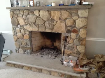

  • I've attached a picture of our fireplace (sorry its dirty!)

  • [Hearth.com] Assistance requested in finding insert for first timers
If you don't want to lose the ambiance of the fireplace, then skip the pellet insert! It won't have the impressive fireview that you want.

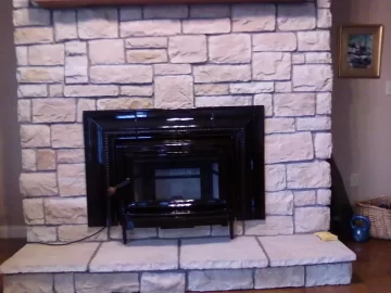

The Hearthstone Clydesdale has a nice fire view, even without a fire in it it's impressive!

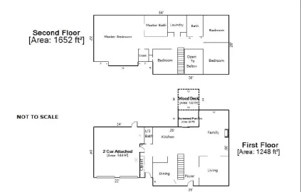

I've included a copy of our floor plan (as measured by our appraisers) to give you an idea of the house (wow I was way off on the sq. footage in my first post - basement is unfinished approx. 1264 sq ft. . What would you do?

I'm getting a total area of 2900 sq ft, not 4500. Does 4500 sq ft include the basement?
