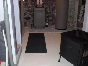

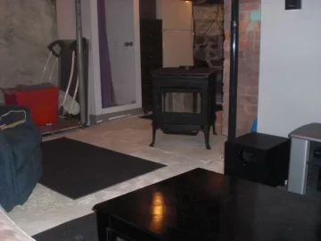

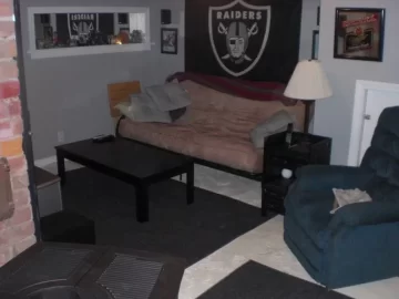

  21. raiderfan
    raiderfan
    Feeling the Heat 2.
    Dec 1, 2008
    257
    4
    Western MA
    That's more or less what I did. I had a room area in my basement with a carpet cut out to fit the whole area of the room. But when I would get water down there (only in spring when it rains AND the snow melts from the ground -- combined) and the water made it over to the carpet, it was a pain in the ass to dry.
    Plans to do the room were in the works, and I was going to get new carpet and cover the whole area again. Started thinking about it and decided that I would just clean thouroghly, and paint the floor with Ben Moore's patio and floor paint. Then I would throw some Home Depot area rugs down there, for the same reasons as you: If they get wet, who cares, hang them out to dry or get new ones.
    The floor came out great with a cream color paint and the dark gray area rugs look good with it. Best thing I ever did. Clean up after having friends over for the game is easy, too.
    As far as concrete staining, I don't know what that entails. But if you wanted to paint it, that should work too. Just use good paint!

  25. raiderfan
    raiderfan
    Feeling the Heat 2.
    Dec 1, 2008
    257
    4
    Western MA
    Here you are, highbody. Some pics of the floor. My house was built in 1895, so the floor wasn't exactly a smooth one!! If your floor is a newer poor, it could look real good with a high quality paint!!
