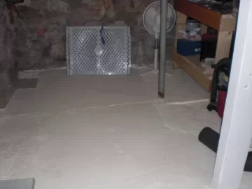

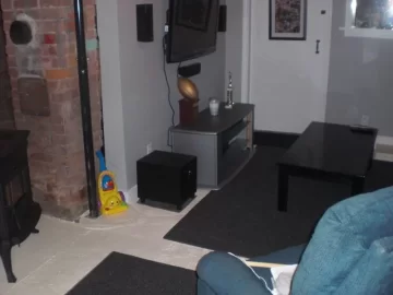

Here's a couple more pics.
My basement is a total of about 800 sq ft. I sectioned off about 300 sq ft. Basement ceiling is too low to put a finished ceiling in, so thats why there are sheetrocked walls and nothing else!!
It is what it is, I guess: A PLACE FOR ME TO HIDE!!!!!!!
Once the wood stove gets piped in, I'm not sure anyone will even see me until April!!!

i like it... i talked it over last night with the g/f... i gave her the options of tiled floors and no walls, or painted floor with walls... she went with the painted/died floor with the walls..
with this option we might have a little left over for some new light fixtures
so with that out of the way, the next step,
should i build a hearth for the p-61? why do people build them up so high? even if the floor is not flammable?

Nice.
Not sure about the hearth. I just put mine where it is and am waiting for it to be piped in. I have no combustibles near my stove, (except for a carrying beam which was 17.5" near my stove pipe. So, I boxed that in with cement board with 1" spacers), so a hearth was not needed. Space was also an issue, as you can pretty much tell!
Before you paint, make sure you use a degreaser on the floor and scrub it in. Then mop it up with clean water. Repeat if you want. That will make sure the paint will adhere to the floor. (I powerwashed mine. Neighbor powerwashed and I sucked up the water with a wet vac). But as I've said, my house/floor is old so it was probably much dirtier than yours.
Once its all clean and dried, start painting with a good quality patio floor/basement floor paint. I did three coats throughout the whole floor. I didn't prime the floor, (have read where people do two coats of primer then paint as many coats as desired after that), so the first coat soaked right in!! I bought a total of 3 gallons of paint, and have some left for future touch ups.

Yeah, epoxy paint will work as well. The Ben Moore Patio and Floor paint is epoxy based. Rustoleum makes a 1-part epoxy paint, too. You are probably talking about the 2-part epoxy paint that you mix though, right? My neighbor does that for his garage, and it comes out nice (he doesn't use the sprinkle chips though). Not sure if that stuff can be tinted or if they have a few stock colors to choose from. The paint I used can be tinted to one of many color choices. My color was called "Patio White".
After cleaning my floor, I used a product called "Concrete Treat". Ordered it online. Its supposed to seal moisture out of the concrete/mortar joints, stopping humidity and efflouresence from coming through. It forms a glass-like barrier that is supposed to be rated as a vapor barrier. I sprayed it on my floor and walls and am happy with it. Its expensive though. Think it cost me $155 to have 5 gallons of it shipped to my house. Google the product and check out the website.
I did not waterproof. Always scared of waterproofing from the inside and trapping water in my foundation where it would freeze and crack. I would rather have water come in and shop vac it up. When water comes in my basement, it comes in on my workbench side and pools up there (in the pic where you see a fan and babygate). Water has only reached the "finished" side 3 times in my 8 yrs living here.
