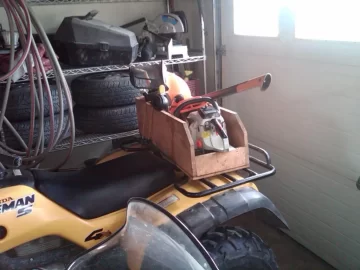

    quads likes this.

    I'm considering making some rails that permanently attach to the front rack. I would dado out some grooves for the plywood bottom to slide into, kinda like a primitive drawer slide...and make it slide in from the side so stop and go doesn't come into play...I don't want it to be a PITA to remove...no tools required. I would have a latch or pin to keep if from sliding side to side. The plywood base will have a saw-sized box to hold the powerhead snugly in place, same for gas, same for oil...and one bungee that goes over the top of all of them to secure. I will probably permanently attach one shortened 5 gallon bucket (with drainage holes) or a crate to the plywood to hold odds and ends. I keep my tools and whatnot in my rear bag so I don't need much "storage".
