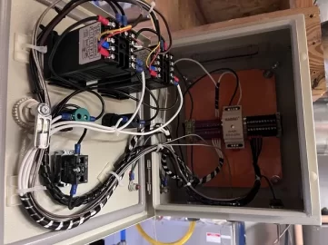

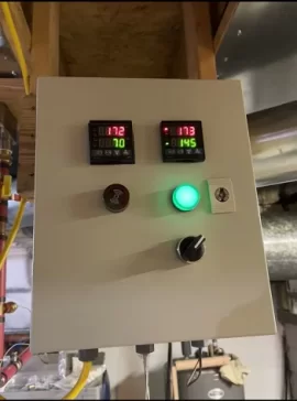

Not wood stove related but I use two Auber PID controllers to monitor the water temperatures on my boiler. I'm using the relay on the one on the right to break Y1 on my geo when the incoming water temperature is above 150F. Bought pretty much everything for the "build" through Auber. They are a great company to work with.
