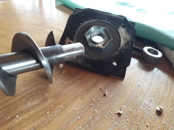

took the auger pin out and also ordered a new motor.

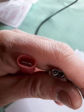

Website said motor was compatible with my stove but it arrived with built in (wrong) electrical connections.
Auger pin fits loosely into the bottom plate, is that normal. Can also see wear marks around the circumference of the auger shank.
I'm thinking I should just use mauretts to rig the new motor with the original connectors and maybe buy a couple washers to put around the bottom plate.

Not a Whit guy,but,some basics.There is an upper auger bushing,bronze.Some looseness is ok,actual side to side movement is not.Same with your lower bushing,weather it is bronze or nylatron.Washers?Do not understand.Auger shafts rarely go bad,some scoring where rides in bushings is no big deal.Having to change wire terminals on an aftermarket motor is not uncommon.You could call ESES or East Coast Hearth,they are very good about giving info over the phone,and very good to buy parts from.
