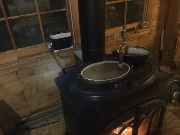

We used to use humidifiers to help with winter dryness, then relied on a stove steam pan. It was a pain to keep filled and often boiled dry. So I created plumbing to always keep it filled.
[Hearth.com] Automatic Steam Pan Filler [Hearth.com] Automatic Steam Pan Filler

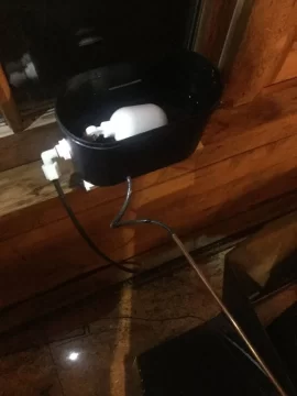

In the picture, behind the stove is a small reservoir that gets well water and a float controls the level. This attaches to a copper tube soldered to a pan on the stove; the levels are the same. Done! Well...
The minerals would add up after a couple of weeks of concentration. So now I'm playing with a second pan receiving water via that ugly siphon (which doesn't break siphon when lifted up!). This is helping a lot, because it is much more concentrated (20 times?) in this added pan and it is easy to empty (which then dilutes both pans).
Work in progress, but ready to share because I had my camera out for another post!

We would never drink the water! It is simply a humidifier and distilled water is all that evaporates, leaving the manganese deposits.
I am hoping to see those deposits melt away now that the second pan is added that I periodically empty out, but too soon to say.
The whole thing looks ugly, but I'm working on functionality at this point. Need more time.

We heat the whole house with just this stove, so it's always steaming away. Also, with the shallow water levels and trickle feed, we never lose a boil and get much more evaporation than when we would periodically fill a tall pan with cold water.

I boil 2800 gallons of water at 50G/hr making maple syrup each spring and understand some of the variables that influence evaporation rates:
continuous boil
The only way to achieve this is with trickle-in or pre-heating. I would guess that before this auto-feed, we had a full boil about 30% of the time when we were attentive.
NH is relatively cold, so we are able to keep our stove hot without overheating the house. Our cookplate is probably over 300F 70% of the time, with the overnight feed being the main lapse (when it is below 10F outside, I'll wake up to do a 4am reload. We do not have oil or gas here.
shallow liquid
In order to improve evaporation rates, you need shallow liquid. (broken link removed to http://www.cceoneida.com/assets/Agriculture-Files/Maple/Liquid-Levels.pdf) you can read that even in a 20 sq ft pan, you do not want to be over 1 inch deep. My pans are about 1/2 in, always.
large surface area
This is the contact area with the stove. I have 2 pans and one is pretty large.
solid heat contact
People don't cook on stove as much, so manufacturers don't always have a flat surface on top. My Jotul is far from flat, with tiny undulations. Also my pan is warped a bit. I use a couple spoons of fine copper dust under the pan to fill those gaps.
