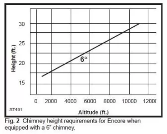

Do you live at a high elevation?
Ding ding! Very good question.
I live at about 3500 ft. I live above a river and am surrounded by mountains.

3500 ft is high, but not as much as say Denver at 5200ft. High altitude air is thinner and requires more chimney to make good draft.

People say 8" pipe should be ok, or might be ok for that stove. But at 3500ft? There are pro's on here who know a whole lot more than me, but I wonder if the 8" is a much bigger issue at that elevation.
