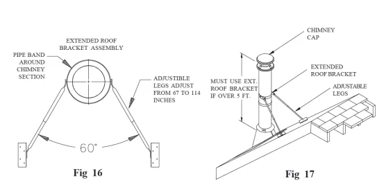

Does anyone have a link describing installation of a brace? I might have to pay someone to do it, as that 10/12 pitch admittedly frightens me a bit, but it depends on what I have to get done once I'm up there.

I think Northline express has an instructional video for bracing on their website.
This is from DuraVent's installation manual:
If the chimney extends more than 5 feet above the roofline, an Extended Roof Bracket must be installed at every 5-foot increment of chimney height above the roofline, leaving no more than 5 feet of chimney extending above the last pipe bracket. The Extended Roof Bracket consists of the Pipe Band, the Adjustable Legs, and the Roof Brackets.
1. Mount Pipe Band: Slip the Pipe Band around the chimney and secure by tightening the nut and bolt.
2. Attach the Legs: The Adjustable Legs of the assembly will adjust from 67" to 114". Secure one end of each Leg to the Pipe Band using the nuts an bolts included (2 per Leg).
Position the Adjustable legs so they form approximately a 60° angle with the chimney, and with each other (Figures 16 and 17). Be sure that there is at least 3" of overlap between the top and bottom halves of the Adjustable Leg.
In order to secure Legs in proper position, there is a hole provided in the outer leg where the outer and inner halves overlap. Use a 1/4" drill bit to drill through the inner leg at that location. Use the nut & bolt provided to pin the Adjustable Legs in position.
3. Install Roof Brackets: Mount the two Roof Brackets where each of the Adjustable Legs meets the roof, using (6) 1" roofing nails per bracket. Seal the nail heads carefully with a non-hardening, waterproof sealant. Attach the bottom end of the Adjustable Legs to the Roof Brackets using the nuts & bolt provided

Thanks, begreen. That doesn't seem too complicated. I'm surprised you just nail through the shingles into the decking -- I've always worked diligently to not poke holes in my roof!
