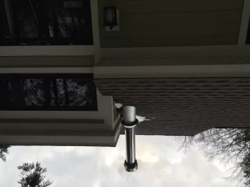

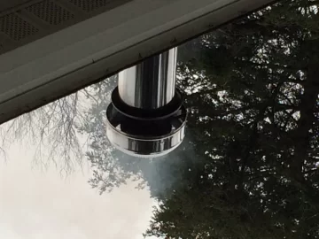

[Hearth.com] backdrafting smoke at pipe connections [Hearth.com] backdrafting smoke at pipe connections I thought I would post a picture of the chimney and cap. I think it's only about 5 ft above the roof here. Do you think I'd need to anchor it if I put up another section? Also, the cap already looks like it would resist down-drafting. Do you agree, or am I missing something? As always, thanks to all of you for collective wisdom.
I'm not sure why those are upside down, or what to do about it. Don't hurt your neck!
