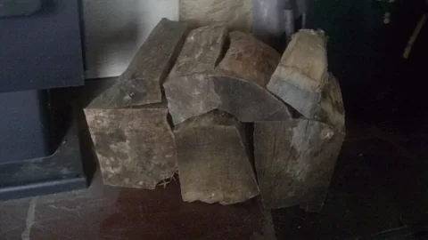

-10 and blowin 20+ I am on 12 hour burn cycles and the house drops to the high 60s. But, those are 125 pound loads every 12 hours.

IS&W's fuel usage seems high, (1500 gallons oil/yr) .
600 ft above the valley on an exposed ridge with 2 floors of glass facing the predominant wind (and the predominant view).
