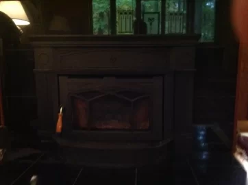

Heres a pic. Zeroclearance metal top sides and bottom. Im not sure if a hi 300 is rated for a zero clearance.

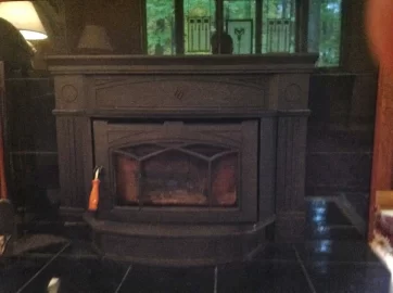

Lightened up the image a bit. Was this a direct vent gas fireplace? Where's the fireplace and chimney? Was this dealer installed?
[Hearth.com] Bad install.
Before the install it was a direct vent factory built fireplace installed when the house was built (78) I dont know the manufacturer. The flu is 8 inch with a 6 inch liner put in by the insert installer. The clearance to the metal sides is about 6 inches top and bottom. The floor looks to have been removed with hardy board replacement. There is a small junction box between the insert and the flu. The hampton H300 specs out clearances at 11 inches for factory built fireplaces.

Direct vent as in gas direct vent? It looks like there are windows above and behind it. Where is the chimney on this unit?

I believe the black polished stone surround is making a mirror image reflecting the window behind the picture taker.
Look closely. It's like a magic eye puzzle!
Got it, the picture is confusing. This is quite a dilemma.
The image has too many reflections to see clearly where the clearance issues are. A tape measure in the picture would help. The 11" side clearance is to the stove body, not the surround and it is 8" to mantel side facing. Even if the clearances are ok though that doesn't solve the missing fireplace floor.
