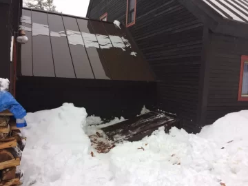

I'm not sure what the builder had in mind here....with the warm temps last weekend, this was not fun. Nor is it fun each and every time it snows and then slides. [Hearth.com] bad roof design
This reminds me of my Uncle's rental property metal roof he painted a couple years ago with an industrial product we use at our shop, PSX700 by PPG. The stuff dries so slick it feels like it's got a nice wax job on it. The snow doesn't like to stick much.
When standing seam really got popular in VT there were several serious injuries and I think a couple of deaths from snow slides off of standing seam roofs. You will see most new standing roofs now have snow breaks as shown above. Some just use snow clips that are less obtrusive but not as effective if the conditions are wrong. If you want to see serious snow brakes, Lucy Hardware along RT 302 in Intervale NH has some serious ones that were added on after the place was built as I expect they had a few near misses. For a brief period one of my employers owned a large aircraft hanger in Milan NH, when that roof let go the snow would slide down and fall off a 2 story roof and hit an adjacent building. That building had been hit many time before and in general the entire wall and sometimes roof needed to be replaced.
Note some roofers specifically exclude any responsibility for leaks after installing snow breaks on an existing roof. Unless there is 100% high temperature roof underlayment under the standing seam its a crap shot if it will leak after the brakes are installed.
On my house they were crimped onto the seams. Been there 25 years now no problem with leaks from them. Kevin
But how much snow do you get?
In Maine it is very common to see no parking signs by the drip lines on metal roofs.
I like that snow guard idea, I'll have to look into that a bit more. I've also considered shingling that section. It's only the mudroom/entryway underneath it. It was built in '87, but I don't think the PO used the bulkhead very much, if at all. My boiler is down there.
I would say the slope for snow was intentional on the thought the doors weren't going to be used much if at all.
The concept for high snow load roofs is generally steep pitch so that the snow slides off instead of staying in place. Great concept except for when snow does build up and lets loose. It doesn't just happen with standing seam metal roofs, slate roofs are well known for the same issue. Its far less of an issue with standard shingles. The guards shown in the post in an earlier post are the way to go but not cheap.
snow slides off or roof caves in- choices choices
Actually the choice is snow slides off or the roof is built to meet the actual snow load in the area. In my area of NH there are potentially heavy snow conditions so the various codes list this as "black zone" which means each community sets the ground snow load generally based on a snow load study developed by a group of structural engineers in the state. While the rest of the state is 40 psf, my town is approximately 95 psf with the town next to me at 115 PSF which is close to the highest in the state except for some unorganized townships that don't have much if any residential housing. 115 PSF is a whole lot of snow piled on a roof!. Its rare but I have seen years where it possible to walk right from the top of the snow piles to the roof. One year my friend in that town had enterprising kids who figured it out and built a sled run from the peak of the garage roof down over the edge and then down an adjacent slope.
The reality for most roof failures is its the details that fail. Pretty rare for the actual structural components to break. Builders take a shortcut one day and the owner finds out about it years later when the conditions are right. I have seen it over the years where someone toe nailed the rafters in place instead of installing strong ties. Or folks cutting out stringers as they are in the way of a sunroof. Or particularly deadly are wide span truss roofs where the stringers are in tension and someone cuts them. Even though my town has a high snow load requirement, enforcement is spotty over the years as some years the town elects not to inspect residential construction to save a buck, the contractors know it and they quickly downgrade to 40 PSF. They are all LLCs and are long gone before anyone is the wiser.
The other contributor is ice damming. Architects like wide overhangs to protect the landscaping and reduce splash back from rain but they are difficult to set up so they don't dam. Ice and water shield helps from water getting back into the house but it still can lead to tons of ice forming on the overhangs. Cold roofs or proper soffits vents can make a big difference but unless the framing is done right there is frequently a warm spot at the point where the joist ties into the top plate. On many homes the soffits vents are dependent on ridge vents that are cheap to install but useless in heavy snow as they get covered over and then the soffit ventilation stops. Gable end vents still work but many folks claim they short circuit the ridge vents and skip them. They add potential issues with blowing snow entering the attic in blizzard conditions but there is an easy fix that most builder skip.
It looks like the roof is doing what is was designed to do perfectly. The basement access door looks to be placed wrong.
