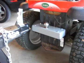

Here's what I did. About $5.
  • [Hearth.com] Ball hitch for my garden tractor

So I get the tractor out of the shed yesterday, bring it up to the garage, get out all the tools, pull out the new bit grab my corded drill....the friggin shank on the new bit is too big for the drill chuck. WTF!, So, for ha ha's, I pull out the cordless drill...the chuck is big enough. Battery is totally dead. So I loaded up the trailer with wood while it charged. Once it was done, it took under a minute to drill the hole out. So, this project was weeks in the making between ordering the ball, getting the bit ect...and the actual drilling out takes less than a minute. Irony.
I'll post some pics this weekend. Thanks for all the suggestions and advice!
