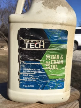

All I've ever used has been Stihl and Husqvarna, both are really sticky and thick. Somewhere along the way I picked up the cheap stuff from Walmart, SuperTech SAE 30. I'm at the end of my Husqvarna and figured I better get the cheap ready, I had no idea it was so much thinner. At first I thought this can't be good, then I realized it might be better in cold weather. After I cleaned, refueled and filled with Husqvarna oil, I started it and the bar struggled to get going. Is it best to switch to a lower viscosity oil for winter?

Yes winter oil is needed in the cold, depending on how cold it gets there. That SAE 30 isn't really winter oil, most winter oil is about SAE 20W.
Supposedly the all season Husqvarna bar oil is good down to 15f (-9c), which I have a hard time believing because their winter oil is like molasses at -4f (-20c). Personally I run almost exclusively Husqvarna winter bar oil, at least up to about 50f (10c) temps. Saves on switching back and forth and worrying about have summer oil in the winter. I always turn up the oil when above freezing, helps keep the dirt out of the bar and chain and limits heat build up. In the winter here a saw needs less bar oil, the dirt is froze keeping it clean, and the snow does a very good job keeping the bar and chain cool.

The temperature was in the high teens when I tested it, the first few times it died when I went to rev it up, it was obviously bogging down on engaging the chain. When filling the Husqvarna oil with it's stickifiers you almost need scissors to cut the oil when you're done, and then it would be stuck to the scissors. LOL

Definitely make carb adjustments in the winter. Usually a saw will make more power in the winter if it is tuned for summer, but at the cost of longevity. They will want run lean when it is cold due to a greater oxygen density in the air and require a bit more rich fuel air mixture to prevent damage from running too lean. It's hard to describe tuning methods in text so the best bet would be to listen to what a "four stroking" chainsaw sounds like. You want the saw to "four stroke" when entering a cut and exiting a cut. If it doesn't adjust the high and low screws until you get what you want. The saw should not "bog" when hitting the throttle (too rich on the L screw) or die out in the high revs (also too rich, but on the H screw). The manual, which can be found online if you lost it, will tell you which direction is rich vs lean. Generally speaking a saw like yours will have limiting caps to prevent catastrophic damage from carb adjustments, but you would know right away if you made a bad adjustment.
When I say the chains are sticky and stiff, I mean tacky like a glue stick and you can still pull it around the bar by hand. The adjustable oiler is more important in the summer to reduce the oil flow, in winter the canola oil will work just fine.

Good to know, today will get up to 45 degrees and will be a good day to play with the carb adjustments. Appreciate it.

I tinkered with my carb adjustments, and it was pretty much dialed in already. Now that I think about it, I rarely use my saw in the summer, but when I do that would be the time to make adjustments.
